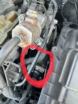

I located and swapped out the heater control solenoid valve today and I am over the moon to say my heaters are working again, it almost seems like a luxury having heat again lol, I'm definitely back in love with my S1, I feel a wheel re-furb and full valet coming :thumbs up:
Excellent news. Glad you got it sorted. For reference where is the valve? Easy to get to?
The valve is on the right side of the engine but it's pretty well hidden. I removed the air box to gain access and uncoupled what I think was an intercooler hose, after that it was pretty easy but I'm definitely gonna look at a decent tool for removing the sprung hose clips in case of any future need for one, You cant see it in the pic but it is underneath the hose where you see a jubilee type clip
Nice one, thanks. Worthwhile getting the tool if you're planning doing maintenance etc, I've had one of these for years, so much better than trying to make do with pliers and screwdrivers or whatever
