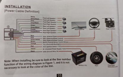

Thanks for getting back to me.

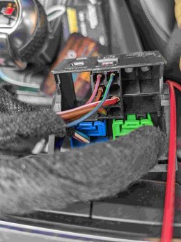

So the year is 2009, my stereo has a quadlock connection see below picture of the car quadlock connector.
PXL 20221105 144749158
I am at work right now, once home I will take the other pictures and update my post.
Cheers

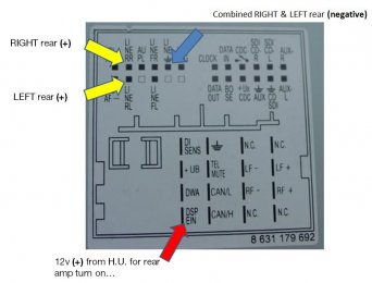

This might help you with the wiring, you need to make sure you are connecting to the 4 inputs and ground of the amp and sending 12v to switch the amp on.

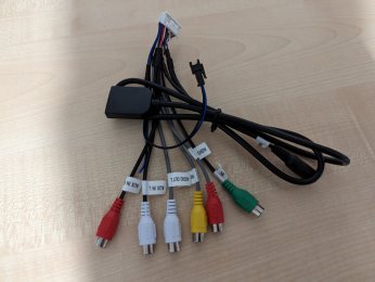

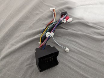

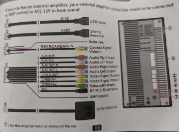

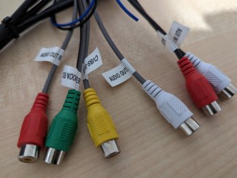

Thank you. It would not edit my last post for some reason but I took some pictures.

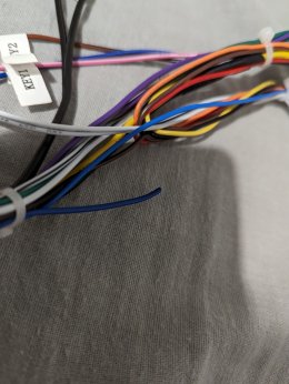

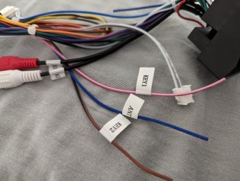

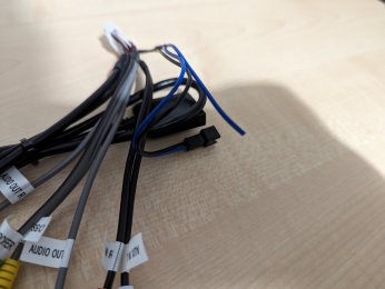

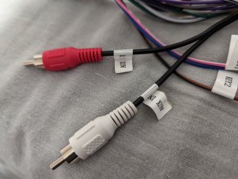

The short blue wire is the amp one, i had originally joined this with the other blue amp wire. I had initially thought I done it wrong as there was no sound, so I cut it and plan to resolder.

Ignore that wiring guide, I have just figured out that was for my old Focus harness. The Audi one I purchased has a different layout, which may explain why I have been experiencing issues. I will see if I can get an accurate diagram, thanks for pointing me in the right direction.
Thanks for being available to provide advice on this one

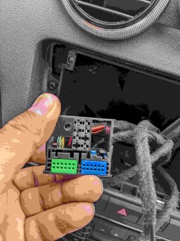

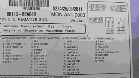

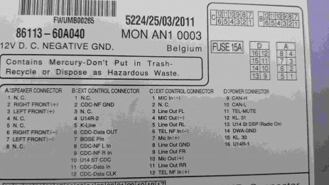

Mine is for Audi A3 2011 supplied with RNS @ navigation plus. BOSE system
Same predicament as Ryan 206 and exact same quad connector with the blue and green 12 female pin connector.

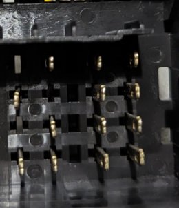

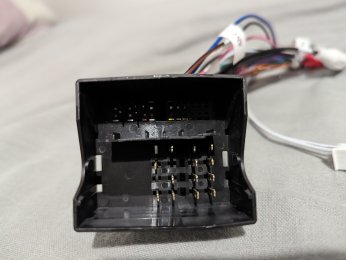

I tried the suggested connections but soon realized it was for a non Bose system .\ Also checking my harness to the radio I couldn’t find the combined Right & Left rear negative.
No sound whatsoever. My connector is not cooperating much as it is as the attached, but I built some lead testers and I am able to insert pins in the female side and couple with the blades on the right side connector.
Your help is much appreciated.
