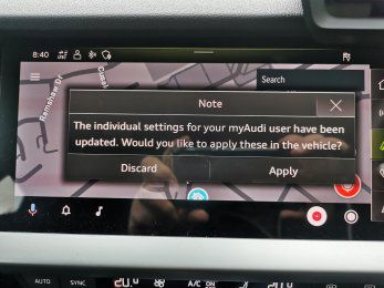

Same as others on here. My 9 month old TFSIe went in yesterday for the £250 :rage: first oil change including some warranty work to look at the attached recurring message on switch on. I took photos of the software versions prior to it going in (MMI 3611). On dropping it off they said they also had to do the SOS recall on the MMI so would need it overnight for this to be done as it's massive and takes ages. For Info I have NEVER seen the SOS message!
Collected it today and ALL versions are exactly the same as before. I have queried this with the service team and await a response.
I suspect they are leaving vehicles updating and for some reason it fails (we've all been there no doubt!) They then maybe are not checking the version has updated!

My dealer got back to me on Friday. The MMI SOS recall is a service patch and will not show as a version update on the MMI screen.
So far in 6 starts of my vehicle since the work, I haven't seen the 'individual settings' message I posted above so it's looking promising that has been solved. ..(There, that's linxed it!:culpability:)
