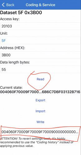

1. Use the CarScanner app to read module 5f, addresses 0x003000 and 5f 0x003B00. These can be found in the coding section of the app under 'dataset dump'. I copied the values out to edit on a computer using a hex editor. I strongly recommend using 010 editor with the templates available from the MQB-blog post linked above, these identify the various bytes and values so you can easily make sense of the hex data.
2. To enable the Audi Sound System & Subwoofer menu I updated the following bytes:

Uploading the dataset back on to the MMI is straightforwards in Car Scanner, the app simply has buttons to either Read or Write to the address. Just go to the address, paste in your updated data, and hit write.

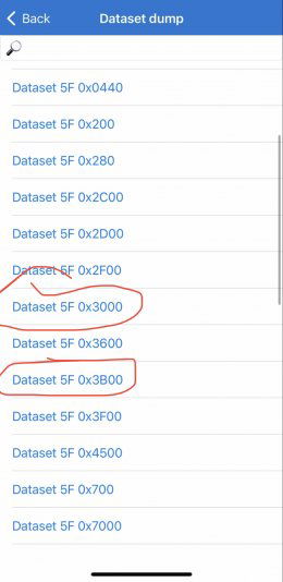

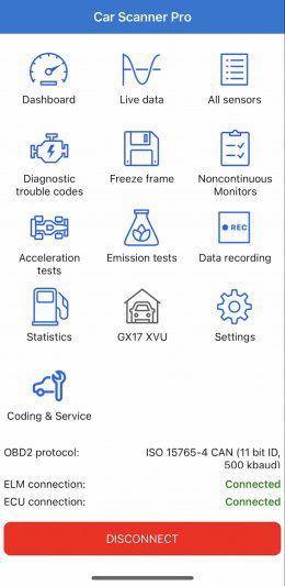

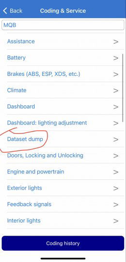

Hi
Assume you are using the Car Scanner app, not the Carista one?
Should be as below

Thanks mate.
Had to enable experimental features to find it!

A brief "How-To"
0x003000
Update Signalflow to 30 (6ch center sub 9.1), this is the first byte in the address
0x003B00
Update Struct Knob Subwoofer range to -9, 0, 9
3. Once the relevant bytes have been updated using a hex editor the checksum for each address must also be updated to avoid any errors. The checksum is the final 2 bytes in each address and is calculated using the CRC-16/CCITT algorithm. To calculate the new checksum take your updated addresses and copy each one without the old checksum into the calculator at crccalc.com and set the input settings as shown below. In this case the checksum to be copied back in would be 0CBC
4. Take your newly updated 0x003000 and 0x003B00 address parameters (without any spaces, new lines, etc.) and use CarScanner to write these back on to their relevant locations on the 5f module. Restart your MMI and everything should now be working.
Any queries let me know, if there's interest I'm happy to expand on this or add some screenshots of the process.
