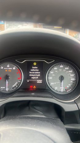

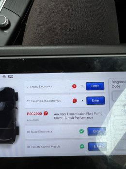

Bought the car a week ago from a private seller today this error poped up any help would be greatly appreciated

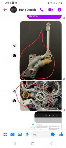

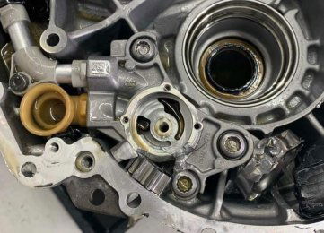

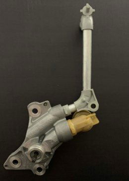

The pump failures are caused by a loosening of a pump fixing bolt. If it drops out it is likely to end up coming through the casing. If it is caught in time they can replace the pump. There have been reports of the securing threads being damaged in the housing requiring a new box.

What really brake is the part inside the gearbox as shown as the OGC.325.577.E or F

The car had the "software update" appointment today. Service advisor brought it back in about 30-40 minutes and reported it had passed their road test too (i.e. no transmission/gearbox code). I asked if they were seeing a lot of these kind of cases/appointments , he said he has done about 10 of them so far and no issues had come up.
About 8 hours later and 148 km driven..., the dash beeped; "gearbox malfunction: you can continue driving in D until engine off"
Disappointing that it didn't happen at the dealer and i have to go back now.
I love my VCDS and thanks to it. i was able to retrieve the following. Looks like our "software update" enabled the gearbox controller with some sort of feedback from the auxiliary hydraulic pump. My theory is that the pump comes lose and won't spin at spec... and feedback is messed up (perhaps someone can better phrase this for us).
Car is at 31K miles and completely stock.
anyways, here is the aftermath Sigh!

The excellent VCDS scanner/tool then allowed me to read the details/DTC as "35494 - Control Circuit for Aux. Trans. Fluid Pump".

While I'm awaiting for the dealer to attempt the repair, i found some workshop study materials and also refreshed my memory on Audi/VW gearbox build codes. the DQ381 is no different... there are various iterations of it; each designated with a 3-letter code.
I checked my PR code sticker and FWIW, mine is an "SKX" code.
2017 S3 with DQ381 SKX
I'll know in a few days; they have the car on schedule for the upcoming week for removal and tear down of the gearbox . At that point, it will either be a pump replacement and refitting of the same gearbox or a new gearbox to be ordered (weeks of wait time i guess...)
and below is the offending part...
Clipboard01

While i wait for the gearbox to be repaired, i had the opportunity to see the guts of it. Not my image, but see below; there is a metal cap on the auxiliary fluid pump, cap held down by four small bolts. In my case, the three screws had fallen off, final screw holding by a mere thread or two for its dear life! it appeared the cap was wobbly and would have come off if the last bolt unscrewed one more turn... I suspect at that point, the cap falls off and gears fall out too; most likely catastrophic results come at that point.
It is probable that with a wobbly cap, the pump can't hold desired pressure or work to design specification. Maybe that's how they are able to sense an impending mechanical failure by means of this so-called "software update"
C572c5ad4314a871b1091665700e
Clipboard012
The pump in question in a DQ 381 SKX seems to be "-E"
I also came across a "-F" pump video showing a much beafy cover/cap. link below.
