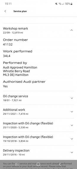

My car is booked into Audi in around 10 days time for a service, after reading this thread I emailed the service department to ask if my car was subject to this recall and they replied saying there were no outstanding recalls for my car, slightly surprised as it's a '67 plate first registered in January 2018
They record it as a workshop remark on the myaudi app

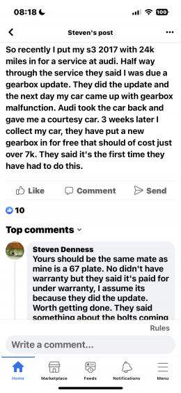

Found this comment on the Facebook forum, it gives a bit of confidence in this.

Car was in yesterday for the check and came back all ok and no faults. Gear changes felt a little smoother but they may have reset all the adaptations and it’s learning again.
Feeling happy that nothing needed doing.
