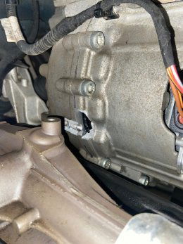

I find this very interesting!! I just got stung with zero help from Audi for my 2017 S3 (24k miles) gearbox to the tune of £7k! Something came loose in gearbox and caused a hole in the casing.. All my research led to a definite issue with the facelift gearboxes but I was met with total disregard and BS from Aberdeen Audi.. This was just last month and I know of another 57 plate bought up here with identical issue

Update from Audi uk this am confirmed the recall is directly related to bolts coming off the hydraulic pump causing internal damage to the gearbox! Opened a new car case with Audi Uk and motor ombudsman case also updated with this recall info..

This is what happened to mine, something internally burst through the casing and Aberdeen Audi refused to investigate root cause! I’ve not been given any explanation of what happened but I have the 381 gearbox … Was told any investigation was to be funded by myself yet the part is an ‘ exchange part ‘ and it’s been sent back to factory and I’m not allowed any information on what they find …
Wow. That’s quite worrying. Need to check if that’s covered under extended warranty.

Aberdeen Audi confirmed my gearbox suffered the exact issue regarding the recall but I’m now waiting to see if it will be covered as the repair was done a week before the recall came out Gearbox went in July , surely can’t weasel out of it…
