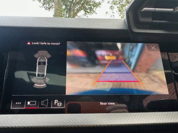

My reversing camera has lost focus. It's now focussed at (I assume) its shortest distance, as everything is blurry apart from anything which is on the camera housing (like water droplets are perfectly in focus!). I can't see any contamination on or in the housing, plus the fact that stuff right up on it is in focus leads me to believe it's not dirt having gotten in or anything like that.
I've not been successful in having it reset/refocus after trying various things like resetting the MMI and leaving the car with the drivers door open for a while to have as much of the electronics power off as possible.
A bit of research online turns up lots of things about "calibrating" the camera but that seems to be more around getting the distance lines on the overlay correct, and mine are still right. It also needs a large calibration sheet printed out, which I'm not really interested in faffing with.
The car is booked in with the dealer for them to have a look at it but that's not until the end of the month (and that's from when I phoned them about it about three weeks ago).
I'm not above disconnecting the battery to have everything in the car reinitialise; presumably there's no big problem with doing that? My Mk 7 Golf threw pretty much every light on the dash when I did it, but just needed a short drive for everything to calibrate and settle down again. Is the same true for this car?
Or, anyone know where I can poke at over OBD11 and/or VCDS to update the focus? All the searching I've done always turns up the aforementioned calibration, but I can't believe this isn't something you can adjust separately!

Calibration Mat and Odis required.
Warranty job for your dealer, no point in trying to do it yourself.

Had the camera looked at yesterday by the dealership. They tried recalibrating it but concluded the unit was defective so replaced it. (Just in case someone else has a similar issue in the future.)
