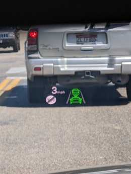

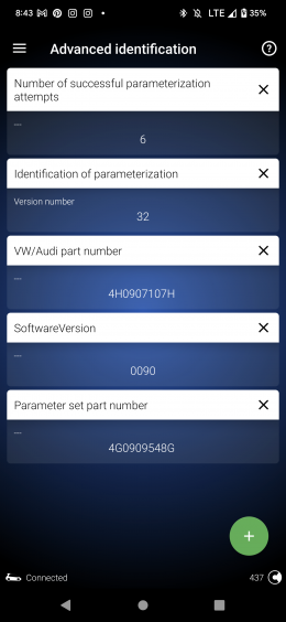

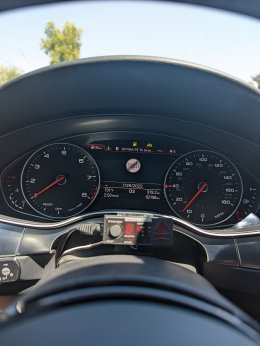

So I've got everything coded. I flashed the parameters onto my image processing module with vag can pro and selected the USA option with TSR. However It still doesn't have the right sign database because occasionally it will actually read a sign but think it's a European one and display the wrong Euro sign. Is the image processor flash supposed to have that database in it or is there a flash I need to do on the camera? Any ideas? Sooo close
