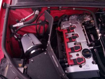

What the title says. There's a kickass *heavily* modded A4 S4 '08 Quattro for 6k I'm very much considering. But I'm 19 and still can't drive manual? (Laugh now).
Would it be completely out of the question insane to convert to an automatic? Whether for practical, logical, monetary or a combination of all three reasons?
Also I'm anticipating several thousand, but I really can't seem to find a good metric for how much I'd have to pay for such an outlandish request.

I wouldn't, it could easily spiral.
Find a nice stronic supercharged one, alternatively if you go for the 2.0 tfsi which is much cheaper to tune, then be wary of the piston ring oil loss issues, fixable but several k.
Would be quicker, cheaper, and more fun to learn to drive a manual. Problem with conversion is your not just taking about a simple mechanical change. There is the wiring harness that would either need to be modified for the Autobox or you would need to buy a new engine bay wiring harness as the gearbox wiring are all part of the engine bay wiring. There is also all the software on the car that needs to know it's been converted to an Auto. Also the interior around the gearbox comes through will need to be changed along with the pedals. Finally you also need to change the front subframe and mounts as they are different.
If you cannot do any of the above work yourself then you looking at many thousands of pounds in labour alone (If you can find a garage that would take the job on) You would also be looking a good few grand in parts. Over all not worth it, just learn to drive a manual.

I'm a bit confused by the "kickass *heavily* modded A4 S4 '08 Quattro for 6k"
2008 S4 would be the B7 4.2 V8.... so i can only assume (from the 4cyl pic) you are referring to a 2008 A4 (S4 replica) 2.0 TFSI with bolt-on's and a tune?!?
