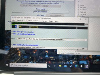

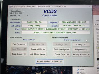

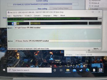

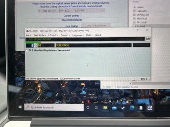

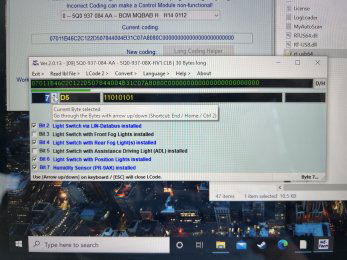

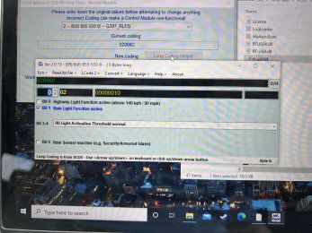

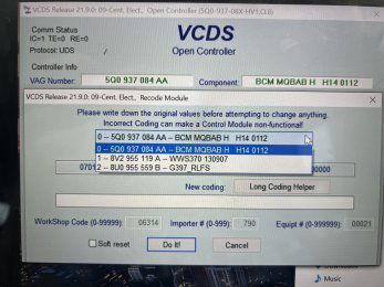

I've got an S3 8V 2013 which came with no auto wipers/headlights. I've installed the sensor 8U0955559B and switch 8V0941531K and made changes in VCDS to code in auto lights but I feel like I've missed something as a message comes up on the instrument cluster saying "Vehicle lights: malfunction!" when I put the switch on the auto setting. It goes away when I turn the lights off or put it on dipped beam manually.
I've read online that there should be a setting to change in the "adaptation" section of VCDS for 09 - Central Electronics, but I can't find anything suitable, for example, I've seen somewhere that there should be a setting for telling the car that a switch with an auto position is installed called 'ENG141658-ENG141992-Außenlicht_uebergreifend-LDS_mit_AFL' but I can't see it anywhere in that list and VCDS has no search function. Maybe I need a security code for it? I dunno. Hopefully someone can help as I'm going out of my mind trying to solve it and nothing seems to help. I have some pictures showing current coding etc. Thanks!
