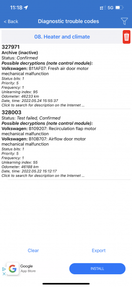

I have looked for error but only have Carista and get the following
Heating and Air Conditioning Faults 2
327971 Manufacturer specific Code
328003 Manufacturer specific Code
So far I have not found the meanings of these codes, any help greatly appreciated,,,,,

I have the exact same issue with my 2018 B9 SQ5.
Carista OBD scan shows:

I’m booked for investigations on 5th July, I’ll let you know outcome if no resolution before
Reactions: bijank
Very helpful, I've printed if off and will leave it in the passenger seat when it goes in
This will also be useful for the Audi technician.

Can now back from investigation work and the technician was grateful for the above information and it did help for sure.
Simply put it was the flap motor at fault and not functioning consistently.
Part required:
AUDI AIR CONDITIONING SERVO MOTOR (VARIOUS MODELS) 4M0820511A
This is now on order and will be fitted on arrival.
All covered by the warrantee I have in place
Hope this helps anyone else in the future.
Cheers Paul
