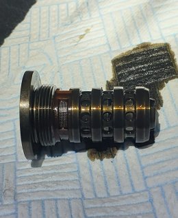

I have changed the oil and taken out the camshaft oil control valve for the variable timing on the intake (tool broke so didn't get to look at exhaust side, but the VCDS fault code was for intake side anyway...) and the part seems to be all ok. Which I was hoping it wouldn't be as that could have been an easy fix.
Will see what the second garage will come back with in the next 2 weeks. It could be the remap...
