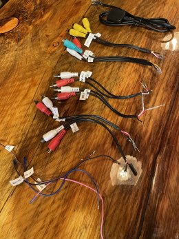

I also depinned the CVBS IN 1 & 2, Video Out RCAs, and SIM card slot to simply the wiring some more as well.

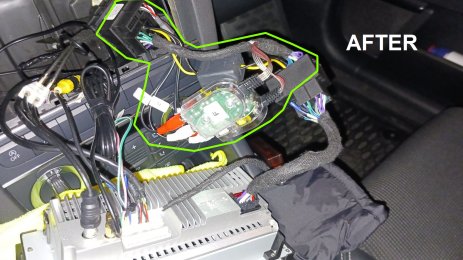

Lots of progress on the XTRONS.
Volume Fluctiation Solved: it was the AudioPilot. I removed the AP mic in the dome and it resolved issue. Going to do the pin 6-24bridge when I’m installing reverse cam to eliminate the 3 beeps on startup.
More Simplification:
I have now removed a good chunk of things that simply won’t be used. I only plan on staying with the Bose system so don’t need sub out or the non canbus connections. Also, if you use the Line Out Conversion kit you don’t need any of the Speaker In RCAs. Attached is what I’ve removed thus far.

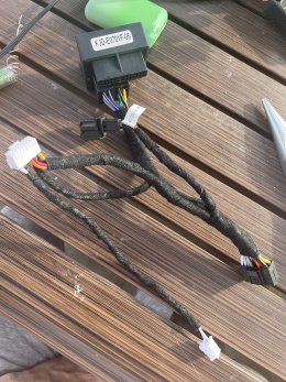

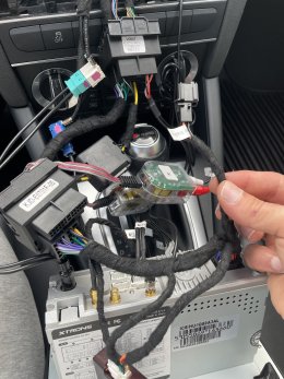

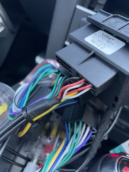

BOSE Pin 7: I took one of the ground wires that are spliced into the main ground to the XTRONS unit then put it into the second quadlock and put the B connector into that Quadlock. This ground wire also had two other grounds spliced to RCA’s that weren’t being used. Now pin 7 is Grounded. I think it sounds much cleaner.
XTRONS Wrong Wiring: when I would be in DSP and adjusting balance for the front it was opposite. Looking at the line level converter harness I noticed the FR and FL wires were in reverse order. Red wires should be on top going to connector C.
OBD ELEVEN: Still no joy on connectivity on Bluetooth. Wip
Reverse Camera Install: I have the OEM trunk handle from a Q7 and camera on the way. Ordering a FAKRA extension and the VW/AUDI connectors to make a harness. Coming off the XTRONS main harness is a Orange and Black cable labeled Reverse-IN. This wire sends a 12v signal when in reverse which I will be using for Power. I’m trying to think how I want to make a harness for the ground and power so it looks very OEM.
Overall this thing is banging. You just have to put in a little work looking at the diagrams. I plan on simplifying even more and putting eliminating the line level harness altogether and making it all on one harness to eliminate the bulk.

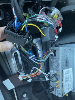

HU Harness & Rear Cam Connector Completed: Finished tidying up the wiring behind the head unit. I ran the Bose 7 ground wire from the RF Filter board and cut a small hole in the case to match and it came out nice. Then wired up the reverse cam connector to the harness and cloth taped it to match OEM. Came out super clean. I will be designing a holder for the impedance converters and Canbus decoder that will move them to just above the empty space above the XTRONS body because if the impedance converters get close to the HVAC panel electronics it starts picking up a lot of RF. When I do that I will also run some better wiring, make some better RCA’s, and replace the crappy female RCA terminals in the impedance converters. Attached are pics of the work.
Waiting on reverse cam and remaining connector to arrive in a few days to finish making the harness’, pin the connectors, and run the wiring. I’ll be bridging 6&24 at the amp as well during this time while I’m back there.

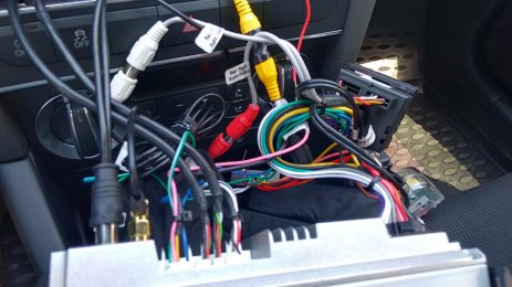

Great job my friend. I have xtrons unit (PSD80A3Al) for audi a3 (bose), and i connected only the main plug from the unit with RCA's. I didn't receive in the package the RF filters. The sound quality is very good, except the background hissing noise when i touch the display, or the volume is low. Also in the subwoofer i hear the voice, not only bass sound. Did you resolve these problems? I would like to know where did you get the home screen dedicated for audi, it is awesome!!!
If you don’t have the impedance converters you will definitely get noise. I am about to upgrade my converters to Kickers to get a better signal to noise ratio. You could do the same but it takes a little bit more than plug and play. I highly recommend getting the converters to eliminate the whine and hiss. You have to order it separately. I also recommend to pour some hot glue over your AudioPilot mic in the upper dome or disconnect it.
Not too sure how to get rid of the voice but it probably has a lot to do with not having the converters. Also might need to use some proper EQ. In the DSP I have mine with the Loud mode in with the sliders in the lowest position. Then I have the Filter on and set to 100hz. This seems to filter out frequencies to the fronts and only send lower to rear and activates the Bose EQ to make only the lower frequencies go to the Sub. I’ll take pics of all my settings here in a minute.

I see this version has an improved graphic. Also i see it displays the battery level. I'm convinced that these filters will eliminate the noise because i tried last week with one K-28 filter which is similar on the front speakers and the noise disappear, but the volume was very weak almost like headphones, and that little black box boost the volume. Thank you for your support and i hope I will handle it.
oh yea I see the PSD80A3Al runs a different firmware. I wouldn't know where to start on tuning this version. But I can say that if the volume is super low with the converters they should have a potentiometer to turn up the gain but you will get more noise as well.
To tune that I would probably turn all gains down to 0 then work from there to get the correct loudness you want then try and do some tuning to get the Sub to do only low frequencies. I don't know if this XTRONS unit has as much DSP ability though to do that.
I have got install the new harness. The noise when touching the screen dissappeared, also no whine noise from alternator, I forgot to mention. But now is some hiss noise when the volume is low. I thought the k-28 filters will solve this but there are simple balance filters between left and right. If I solder the RCA's cables then I will disconnect the AudioPilot the noise will be gone or will be lower?
Ok, I misunderstood. I figured out all connections, no RCA cables now. I see the BOSE pin no. 7 on your pictures, but where does it come from?
