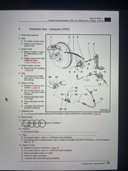

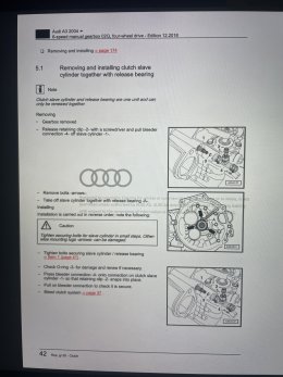

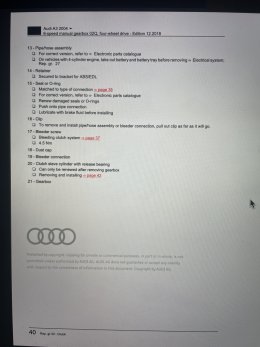

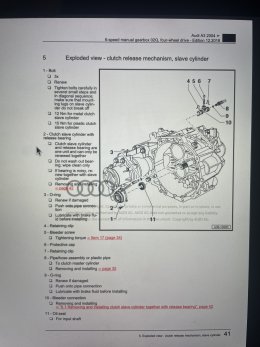

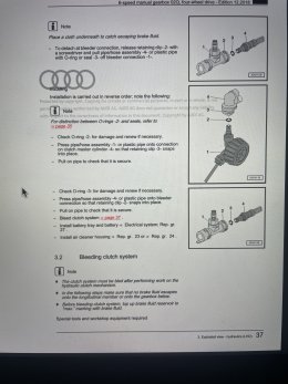

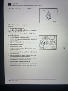

I just posted on the other thread but looks like you have done most of what I suggested above.
also I have had a diesel Passat csc plastic one split under pressure down the tube after about 1k miles so always use metal ones now- side point I know but
Do try filling before fitting and keeping the level on resivoir to almost brimming until done and remove to max line once done.
Let us all know if you find a way to do once and for all that works as I always have issues with doing these also.
pain in the **** they are sometimes.
Good luck with it mate.
also - does the pedal go to the floor and not coming back up unless you pull it or is pedal working but not selecting gears?
If you don’t already have,…
This is for the s3 bhz should be same but if you tell me the car and engine code, I can do same for your specific car if you need mate.
I haven’t read it yet I will in a min but thought I’d get it on here first in case you are still working now.

Alright mate
How did you get on in the end, I did mine yesterday and pressure bled through resivoir and return back to bleeder secondary tank.
followed Audi procedure -
It was pretty black and sunk to bottom that came out so did all lines to callipers in sequence and clear fluid now.
clutch took about 5-10 mins and all good
I keep level at almost brimming before connecting pressure bleeder and only just less than 1/4 turn as a mate told me they can pull in air (can’t see how being pressurised from top) but do anyway as habit
if air or loss of fluid, the pedal will just slam to floor usually when slightly pressed so was wondering if you have re set up linkage-
the locking pin on front of box and the 5mm pin in selector as you have unbolted the bracket I’m sure to get box off
keep us posted as it may help other members in future
