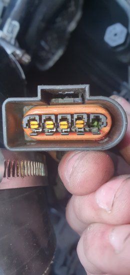

Audi s3 8l maf sensor plug missing pins?
JD S38l
Feb 3, 2022
Andover
Hi I have an audi s3 8l and is running rough on tick over and am wondering if my maf sensor plug is missing a pin?
Could anyone confirm for me?
Typically only 4pins as the 5th is IAT on some other VAG models thats not applicable to S3/A3
