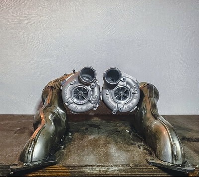

When i look for recon ones on eBay they always say “upgrade” in the title. Could you send me a link to a good option for replacement?
Example, could this one work? I have no tune on it now, only sport cats.

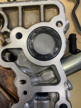

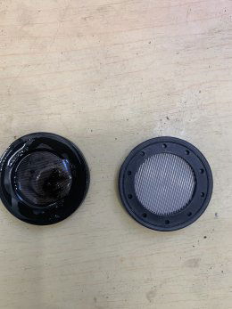

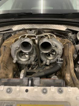

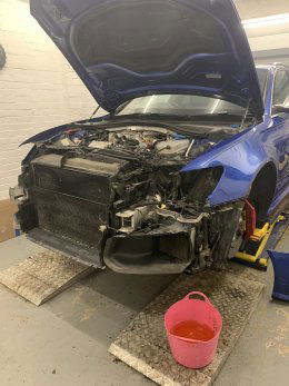

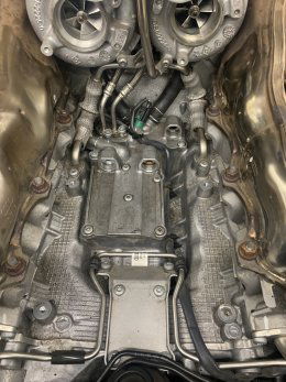

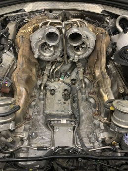

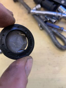

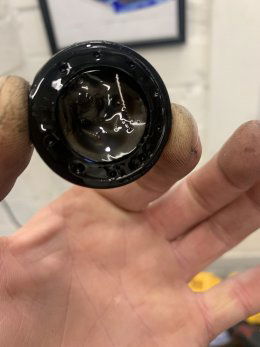

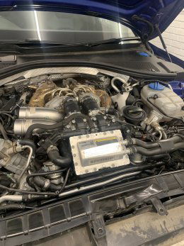

Just yesterday I got all the way down to taking the turbos off as I was replacing the turbo screen because of this reason,took about 10 hours steady away,the tools you need are basic really,and there’s a full right up on here I think to do the job,I’m a joiner by trade but have a little knowledge of car mechanics
I’m impressed, even though I’m reasonably competent around my car, I’d be slightly daunted undertaking this job!
What turbos/supplier did you go with, and did you get stung with import duty if sourced from Europe/China, or were you just stripping down to do the oil screen job?
Everything working ok now? A lot of people (and suppliers) recommend taking the oil screens out and not replacing, was there a reason you decided to put the latest version back in?
Did you make a decision on which turbos to purchase! EBay seems to be a bit of a minefield.

I was just replacing the turbo screen but while I was in there I replaced the pcv valve,check valve and control valve just while I was down to that point,I live in the UK so no import charges,I replaced the screen with the newest Version as it was only £4.61 and my old one lasted 58000 miles and probably not do that many miles in the car again,I don’t know with out it it would affect oil pressure to the turbos,I know loads of people don’t put it back in and all is fine,I put the car back together with no problems and all is fine,I’m a joiner/Carpenter so if I can do it anyone can,it’s a big job and a few bolts I had to loosen just by feel but other than that is quite straight forward
