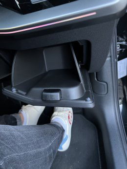

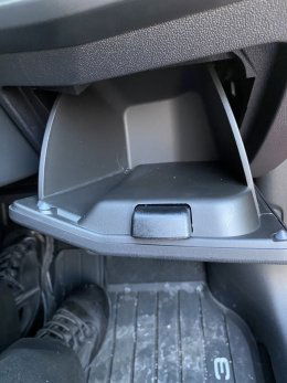

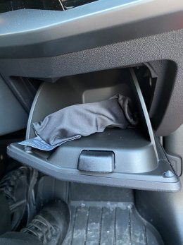

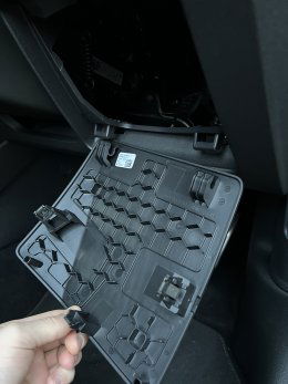

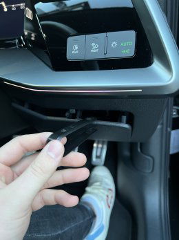

Picked it up today and was so easy to install - I actually used the fuse removal tool that was in my glovebox to open up the blanked plate, there’s a small push-clip that holds it in place.
Then it was as simple as pointing it towards the floor, then it became unhinged, then did the opposite with the new storage compartment.
My only grievance is that is was not as large as I expected, which means I can’t get my sunglasses case inside, nevertheless still useful to store my junk e.g. chewing gums and my wallet!
@creweaudiparts - so this was indeed the correct part number, for future enquiries.

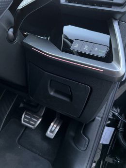

My part arrived today so many thanks to Tom @creweaudiparts .
Also thanks to thomaslewis for posting the info in the first place.
Easy to remove the old cover and pop in the wee glove box.
Luckily my Oakley sunglasses fit in it so result all round.
