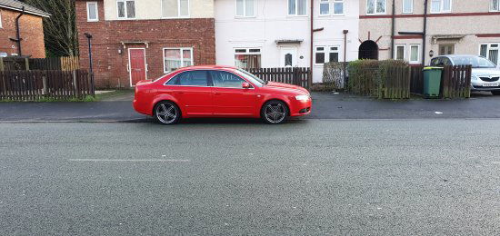

Had this just over a month. Loads better on fuel than my s3 8l but it does have a little issue. I have permanent code p3102 show up and it goes into limp mode with glowplug light flashing when on motorway. Took it to a garage to get diagnosed and they have said i need a new manifold but after searching on here is pointing to either a fuse or the intake flap. Not the ones in the manifold. I will be looking at getting a new inlet manifold without flaps, dpf and egr delete with a map in the future. But would like to try and get it running right 1st. Hopefully it doesnt turn into a ko ey put like my s3
