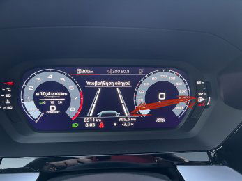

The PROBLEM is..... in both ECU remaps the fuel consumption is HUGE even if the AF ration is perfect in remap... My trip computer when i top refilling fuel getting like 740-750km on screen i am actualy getting 400-450km with whole fuel tank. Its like my car is 35-40% more fuel hungry. If i drive normaly i am max getting like 500km.
Anyone tried to remap his A3 getting any similar problem or something ? I believe has to do with DSG or something. A friend with Leon FR but manual gearbox doesnt have this problem :(

I have almost the same consumption without ECU REMAP.. It's the normal for our city. Unless you go normal speeds on empty road I have 7-8.5. But how often do you go with normal speeds?

on my stock ECU i had between 6.7-7.2l/100km with normal driving and mixed city-coasting
