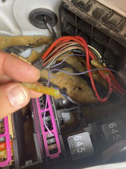

Hi all,
I have read quite a number of posts regarding issues with the 5F module so I wanted to post my issue to see if anyone can help (apologies, it is a little long winded).
everything was working fine on my 2012 A5 (facelift model), then the mmi control unit started randomly stopping working. Then after a few weeks it stopped working altogether. However, everything else in the car works radio, Bluetooth, navigation etc but I can only control them with the steering wheel controls or voice command (not the best with a Welsh accent). Took it to Audi who said the mmi control unit needed to be replaced, so they changed it (£1000+) but then said “sorry it wasn’t that, it is the 5F module” which the quote £3000+. So after telling them to take a long walk off a short pier, I decided to look into getting this fixed myself. I have tried to change the byte 14 bite 5, as discussed on this and a lot of other sites but no joy. I spoke to an independent garage who said I could purchase a used unit and they would recode and remove the CP but they wanted me to pay for diagnostic charge for them to check it out first etc.
I am just hoping that someone can offer some advise on 1, if I can possibly fix this myself using VCDS, or 2, I just buy a second had 5F module and get the garage to sort it.
I would appreciate any advice anyone can offer. I did a scan and I have stated the error code I am getting. I wanted to post a video of the unit but not sure how. Also, don’t know if this makes a difference but the two silver buttons to the right of the know on the control unit flash and I am able to do the three button reset but none of the other buttons work.
thanks

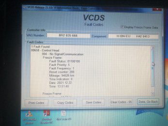

Looks like you have a CAN Gateway wire issue as you have two faults there
Address 19: CAN Gateway (J533)
one for the Control Module for Battery Monitoring which i think must be a module on the end of the battery wires (could be wrong) and one for Voltage Regulator which i think is on the alternator.
Have you tried disconnecting battery for a few mins and reconnect? check wires there and at alternator maybe?
No not tried that. I think the battery is the same one it came out of the factory with lol so I was assuming that those errors was due to that plus the stop/start doesn’t work, which from looking online, it could be because the battery is old and doesn’t have enough juice in it.
But it is certainly worth a shot. I will give it a go later and let you know the out come.
Yeah give battery replacement a shot. Let us know, I'm intrigued :)

Just an update. Checked the cable as suggested in the other link, it was broken and badly corroded. So fixed this and now I am getting battery readings in vcds plus the start stop is now working.
Only thing is now I have got 3 error codes for the 5f unit :
Address 5F: Information Electr. (J794) Labels:. 4E0-035-6xx-5F.clb
Part No SW: 8R2 035 666 HW: 8R2 035 666
Component: H-BN-EU H42 0413
Revision: -------- Serial number: 066IY0B7500536
Coding: 130101020006A1ED05808B5E00002403E40000020000000000
Shop #: WSC 06325 000 00000
VCID: 76E353DFC1C7343BE9-8022
Subsystem 1 - Part No: 8R0 060 884 N
Component: EUR 2011 1205
Subsystem 2 - Part No SW: 8R0 919 604 HW: 8R0 919 604
Component: DU7 High H41 0104
Serial number: A130I40BS023428
Subsystem 3 - Part No: 8R0 060 961 B
Component: CD-Database 3371
3 Faults Found:
00658 - Control Head
004 - No Signal/Communication
Freeze Frame:
Fault Status: 01100100
Fault Priority: 5
Fault Frequency: 1
Reset counter: 200
Mileage: 94626 km
Time Indication: 0
Date: 2021.12.22
Time: 13:51:40
Freeze Frame:
Voltage: 11.60 V
012 - Electrical Fault in Circuit
Freeze Frame:
Fault Status: 01101100
Fault Priority: 5
Fault Frequency: 1
Reset counter: 205
Mileage: 94761 km
Time Indication: 0
Date: 2021.12.29
Time: 15:18:38
Freeze Frame:
Voltage: 12.10 V
Bin. Bits: 001
03157 - Functionality limited due to Communications Disruption
000 - - - Intermittent
Freeze Frame:
Fault Status: 00100000
Fault Priority: 6
Fault Frequency: 2
Reset counter: 245
Mileage: 94761 km
Time Indication: 0
Date: 2021.12.29
Time: 14:47:53
Freeze Frame:
Bin. Bits: 00000000 00000000
Bin. Bits: 00000000 10000000
If I can get this fixed and get the mmi control unit working (plus I got to check the drivers heated mirror as that has an error also) then I’m a very happy man

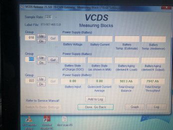

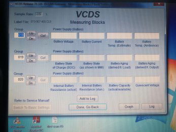

Little update - stop start has stopped working but he battery is only at 24-25ah which is really low, so I guess I’m needing a new battery. But after checking a few forums, I noticed on the 5F part of the full scan, there should be 4 subsystems but mine is only showing 3 and guess which one that is. So I will need to work out why it’s not appearing, possibly a faulty cable somewhere. So will update you once I can do further checks.
also, the radio is now giving me a fault code (03278 - functionality limited due to missing messages) but the radio is working fine. Could be connected to the low battery and control module issue but will also update you once I know more
Reactions: losmi200

@MatjjA5
after checking the wires under the right rear light i ran into a problem. the three wires that were connected to each other were no longer together. i connected them and the start/stop system works again the battery gauge also shows how full the battery is again. thanks a lot for the idea where to check the wires.
Violet-blue wires
IMG 3443
