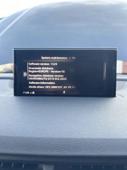

I run the MIB tool latest v.1.2 (i think) and all went well in my audi Q5/2018 with MU1329.
Now I am running the MAP update 2023.
I have a question: Will the Audi CONNECT and TRAFIC DATA be enabled again or do i need to run more stuff from the M.I.B. tool in GREEN MENU ? does anyone know the procedure here? I ready somewhere in a post that some were successful to enable both.
thanks

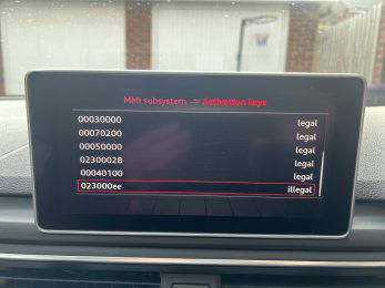

Hi everyone. Great info on here and all are really helpfull.
ive got through the thread up and completed the patch but it now says the 23000ee it Illegal.
Any help would be great
Just to add. Reading the message from MIB, Audi have made them remove the software? Maybe we cant do this orocess any more
