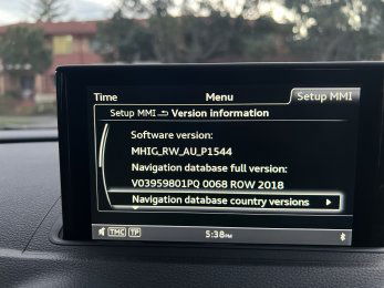

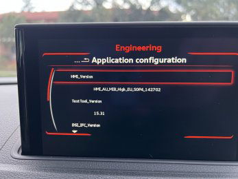

Hi guys, I've been of site for a while.
I have an RS3 2015 PFL. I have 2018 Auatralia maps but would like to update it to the latest I can. I have the silver buttons. From what I read I may be on the MIB 2 High.
Where do I start? This is what I'm on atm. Maybe there is a guide somewhere I may have missed.

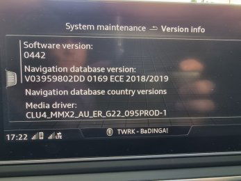

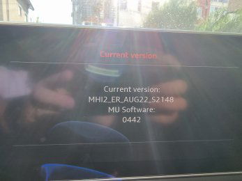

Hi guys.
I've been reading all this thread and I would like to do this firmware update + maps update on my Audi.
I looked in that list with firmware versions but I didn't found one to contain exactly the name of mine.
I have MIB2 High with MU Software version 0442 and Current version: MHI2_ER_AUG22_S2148.
Can someone help to tell me which version can I download and use from those available from that list ?
Similar with my version I found in that list the next ones:
MHI2_ER_AUG22_K2140_1 MU0358
MHI2_ER_AUG22_K2161 MU1421
MHI2_ER_AUG22_P3241 MU0678
Thank you very much.

It looks like your firmware is old and will need updating. I am not sure on this procedure but you should be able to get the firmware from where you got the MIB tool
Reactions: Alin Lupu
Thank you for your reply @alpesh26.
I was thinking that someone can help me to do it myself the update for firmware and maps. The car is out of guarantee and the dealer want to take a lot of money from us for a simple update, that's why I am looking to do it myself.
@henkkeumus please can you guide me a bit in order to realize this updated (firmware & maps) ? I don't know which version from your list of MU software it's dedicated for my navigation. Which one I need to download it ?
Thanks & Kind regards

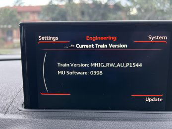

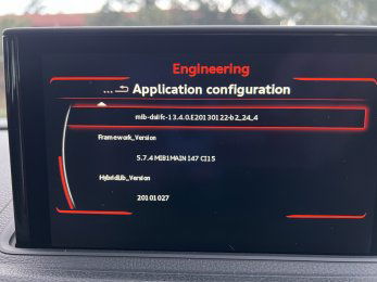

Hello Chelios,
Did you find a solution for udpating your MIB1?
I've got exactly the same version as you (Audi S3 8v 2015):
MHIG_EU_AU_S1544
MU 0397
I check on the internet for few days t find a way to update my MIB1 GPS without success :frown new:.
So please let me know if you did it successfully :blush:
Thanks in advance.

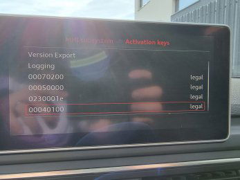

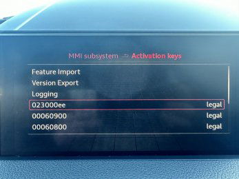

Hi, exactly what I need. I have 2 question:
1) The link does not work anymore, could you name the software so I can download somewhere else
2) The greenscreen... Actually on my A5 sportback 2017 is not enabled, will it be enabled from the update (step 4?
thanks for your answers already
Hey mate,
With VC Dash you have a MIH2 (MIB2 High) unit yes.
1) License for my navigation updates is valid until March of this year, does that mean that I can update without hack? Since general procedure from Audi involves also updating map vis SD card...
Yes, if you have an Audi license active you can just update online.. You MIH2 unit will have a connection to the Audi servers. However, downloading 25GB over the 2G in your car can take a long time so it's quicker to do with the SD-card indeed. I've read that the Audi servers were sh*t the last couple of months so I would rather just go for the SD-card option indeed.
Just download the maps, put them on your FAT32 SD-card and go into the REM menu (hold NAV + MEDIA for 10sec) then choose update > SD-card slot 1 > and let the system find the update and start it.
NOTE: NEVER SHUT YOUR ENGINE OFF DURING THE UPDATE AND MAKE SURE START/STOP IS DISABLED. WHEN YOU LOSE POWER IN THE MIDDLE OF AN UPDATE YOU CAN POTENTIALLY BRICK YOUR SYSTEM.
2) Concerning software version of the MMI, I see on your photo that is version 1326, and my is only 0875. How do I update software on MMI? Is that different than updating map and navigation?
This is the version of the DB of the navigation, do you have the latest firmware on your system? You can check that by going into the REM menu (hold NAV + MEDIA button for 10sec) then a red menu appears and choose the 'Version information'. Post it to me in DM and I can see if you are on the latest firmware.
If you need to update this, it's very simple. I can help you out with that, just send me a PM and I will share the firmware with you (official firmware) to update your MIH2 unit.

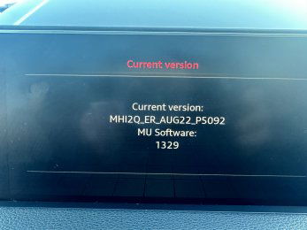

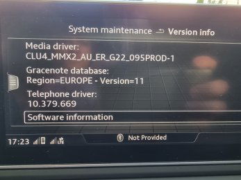

Hi everyone, just read this post as I am looking to update my Audi Q7 maps.
Current version: MHI2Q_ER_AUG22_P5092
MU: 1329
The links for the MIB software don’t appear to be working anymore so I cannot currently check if a solution exists for my version
Any help greatly appreciated, there are a few of you who have clearly grasped this and updated to the latest maps, incredible really when you consider the Audi charges!
Indeed they are as I've already updated mine on my FL S3 ;)

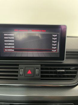

I have a few other questions as well, apologies if I am missing something really obvious in the thread.
Following the MIB patch and map update:
1-Do the Audi connect services and live traffic still work?
2-I have the software version 1329 with the satellite maps post google. Will the satellite update still behave as expected?
It almost seems to good to be true if the maps and live traffic/connect functionality behave exactly the same as a £500 Audi upgrade

Following this forum for a while and decided finally patch the Audi Q5 2017 to get the latest maps.
Current Firmware: MHI2Q_ER_AUG22_P5092vMU Software:1329.
I followed the posts and installed MIB 3.41.1 which enabled the green menu. Then downloaded the patches folder and copied the right patch "MHI2Q_ER_AUG22_P5092_MU1329_PATCH" and did the AIO patch. The patch was successful and I have the FEC codes loaded. Not exactly followed the instruction as I didn't have the patch in the patches folder during the MIB installation.
Then I download the maps.P313_N60S5MIBH3_ROW.7z to another SD CARD. The SD CARD had only contents at the root. i.e metainfo2.txt, Mib1 and Mib2. This was all done using a windows laptop. SD card was formatted to ExFAT.
I keep getting this message every time I update the maps " No valid update data found on the medium" even though I have the FEC codes.
Not sure what I am doing wrong there. Any help is appreciated.

Does anyone know how to update maps on a MIB1high? I have a Audi A3 8v limo 2014 and would like to update to new maps. Thanks in advance!
So hooked up to the trickle charger, prepared my SD cards and completed the MIB installation and I am not ready to update to the new maps but will do this tomorrow as I have ran out of time.
All worked perfectly as expected, amazing tool. Thanks to all on this thread for pointing me to the correct resources!
