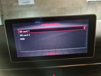

Hey guys, in REM, after I select the 'Update', I'm presented with the option to select the media to uodate from.. I have the formatted card (FAT32) in 'SD card 1' slot but all options are greyed out. Any idea?

Got to MIB then download M.I.B 3.2.0
With in the program there is a folder called "patches" it say place patches here. Download the folder M.I.B patches & from there select the patch you need and drop that in to the M.I.B patches folder.
Put this on to a fat32 SD card and insert in to SD1.
Then got to you red menu and you should be able to install the More Incredible Bash program "M.I.B. Launcher V1.0". After that Push both buttons, nav & radio forward together. You should now be able to access the green menu. Select backup firmware. Then flash fec.
If you wanted to update your firmware to the latest version first that can be found on the page M.I.B too

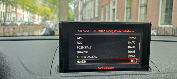

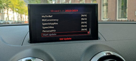

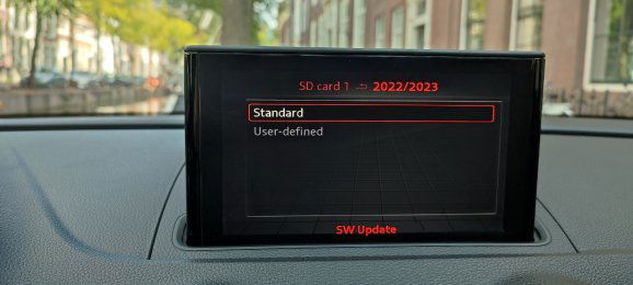

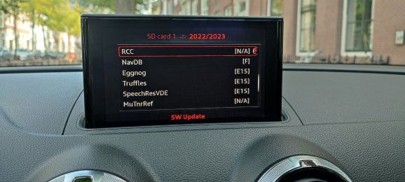

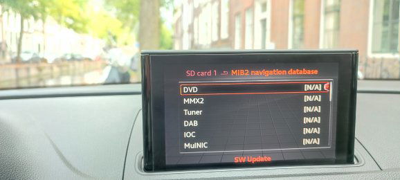

Hi Henk, Thanks a lot for supporting. I have an Audi A3 2018 dutch car. I have already patched the MIB unit and have 23000ee for map updates. I have tried to update the maps via the VW maps with SD card. I tried many times but I get an error in the Metafile is not compatible with my car. I have MIB2 high. any idea where I am making mistake.
Mmmmm.... Maybe try redownloading the map?
I re-downloaded the maps and my car detect the Nav database, but I am stuck at "start update". the option for "start update" is grey out.

I use the red engineering menu to update.

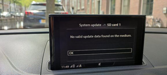

I tried with the Audi connect and select update and receive this message. I do not know what mistake I am making.

Either fec isn't valid or the map isnt for your mmi
I have checked the FEC it is legal and MAP detected as 2022/2023 Nav database but did not start the update. Thanks a lot for your help. Maybe this is not my cup of tea.
