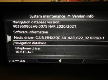

Please let me know if you have an update for my Audi q7 software version 1178. Thanks.
Thats not an MIH2 unit, so sorry, cant help you with that.

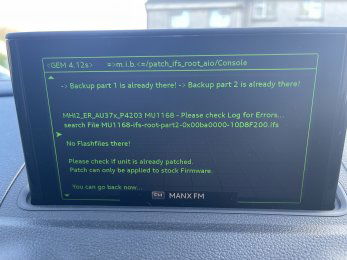

Hi folks - first time poster so go easy. Thanks for this - most helpful. I have followed the instructions, gone into the red menu, flashed with the exact same firmware as was already on my car. Then into green menu, took a full backup. I already had Apple car play so just wanted the lifetime maps but get an error "addFecs.txt not found - fetching from backup". I have copied the addfecs.txt file to /patches in fact dotted it everywhere but it still says it cant find the file.
Any pointers as to what I am doing wrong?
You should install MIB via the red menu. Which you obviously have then Go to the green menu and select to flash firmware and then flash fec file.
Hi Booboo. Thanks for trying to help me out here. I re-did the SD card and flashed with the green menu. It said Apple car play and Android was active. No error this time. When I try and update the map to 2022 version I get No update can be found on this medium. Back into red engineering menu and check FEC installed I still have 02300026 which is 2020/2021 maps. I cannot for the life of me get the FEC code to update. I'll try again later and take some pictures of the process and hopefully you can point me where I am going wrong?
If the process is success full you'll see 23000ee in the fec code list 2300026 will still be there too

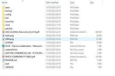

Still not successful but here is what I did :-
I had a thought that when I originally went into green menu to patch MIB I didn't have the exceptions.txt or addfecs.txt in the /patches folder because I don't read instructions properly. Decided to restore the original backup folder to an SD card and restore it back to pre-fiddle. This went well.
I then formatted the SD card as FAT32 again and copied the contents of MIB onto the card (See folderstructure.jpg). I then copied the entire contents of (folderstructure2.jpg) to the /patches folder which I did not do before. Went to the car and inserted SD Card into slot 1, started green menu and hit patch ifs_root in the menu and it immediately came up with Android and CarPlay active and then ran some backups then gave the what I assume is an error in IMG-0696.jpg attached but the file it says it cannot find was in the /patches directory.
Just to finish I did check red menu and no code 023000ee in there. Just the original ones.
Please help!

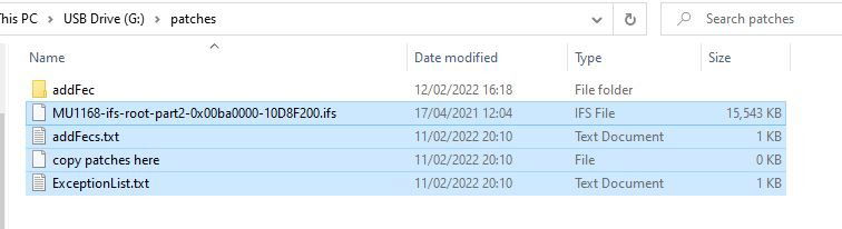

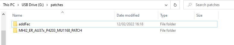

Success!
Hopefully this will save people some time. There is a folder called patches which says "Copy patches here". I did, literally extract the patch and the .txt files to here. I was completely wrong. You need to copy the patch FOLDER to the /patches directory and ensure the addfec.txt and exceptions.txt are contained within. Hopefully the images attached will make sense.
Thank you to Booboo for the help. Think I may stick around here as it looks a great community.
Thanks!
Reactions: asq550, Comrade, mirec242 and 1 other person

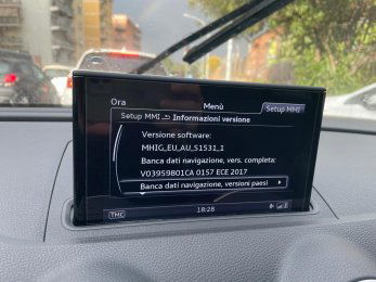

I'm struggling to work all this out going on my software and map version for my 2017 FL s3 8v are there any update for either .?

How did you do that navi update on the mib1 high+? I have the navigation update put on sd kart 1 but my mib 1 &high+ didnt instal it. Its the same what you had on youre screen. Must i also instal the patch on mib1 high+?
I think I'm in the same situation.
Please, can someone help me to understand what procedure I've to follow to unlock my mmi (mib 1, I suppose...)?
My software code is "MHIG..." and I didn't found any modded firmware in the repository of the post #74 (MHIG folder is empty). Can I apply the M.I.B. hack on the original firmware as well?
Thanks.
