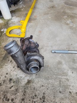

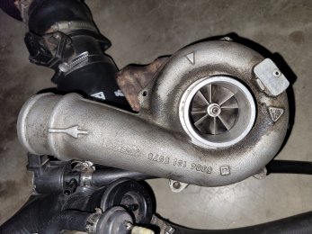

I am new to this forum and hoping someome on here will be able to assist me.I have an S3 8l with a bad boost creep issue. Thought the car maybe had a wastegate port size issue. I have attached the turbo pictures, anyone can confirm if this is an original borg warner turbo.the tag is worn out so can see the blue but can see the part number and serial number.

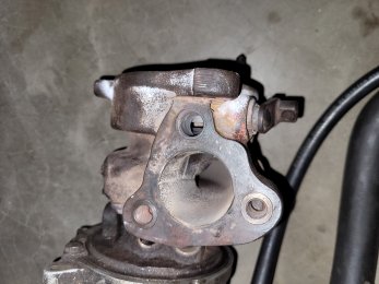

More pictures of the turbo attached.

Looks like a genuine turbo from the pics... no pics of the actuator though?

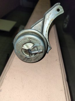

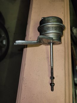

Yeah sorry I removed the actuator off the turbo. Please view actuator pictures.
If the bad boost creep is not the turbo, guess Im at a loss at what causing the issue.
