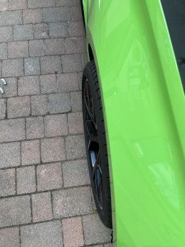

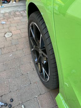

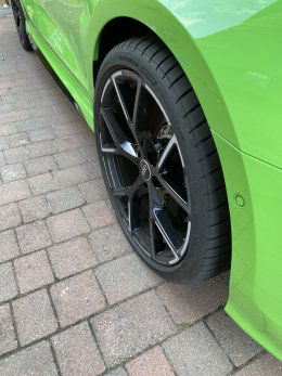

Fitted the 15mm spacers I had from my launch edition. These are bit to much and close to rubbing on full lock with the Bridgestone tires so I’ll try the 10mm ones as I’ll soon be lowering it with eibach pros which is 20mm drop.
standard
View attachment 258718View attachment 258719View attachment 258720
15mm Spacers
View attachment 258724View attachment 258726View attachment 258727View attachment 258728View attachment 258729
And here is inside the fender on hard lock
View attachment 258730View attachment 258731
Mate, use a heat gun on the inner plastic liner and mould it in slightly so your tyre doesn't scrape. Easy fix.
To be honest that’s not what I’m worried about, my launch edition had no paint left on the rear arches! It can rub the plastic all it wants haha but come a year or so if it’s the metal with no paint, that will just rust.
