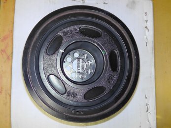

Here's a photo of my OE pulley which was removed at less than 10K. The polymer (a.k.a. rubber) is visible in the 5 ovalish holes and the circular gap between the two parts. If you press it there will be slight give, and with great effort you can just about feel the flex between the two parts. Most of the photos I have seen of failed pulleys are of catastrophic failures, but I have seen some which are whole but there are cracks visible in the polymer.
Newish crank pulley
FYI I have a Vdamper which is the Fluidampr core with an outer ring made by IABED engineering. I believe the outer ring is aluminium yet the whole thing is still noticeably heavier than the OE damper - I think it's over 6kg: https://www.audizine.com/forum/showthread.php/842652-Crank-Pulley-Weights
