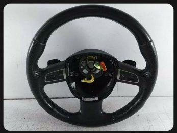

Hey all,
Been given a 3 spoke steering wheel from a friend who never installed it, and with my overalls worn 4 spoke looks like a good option.
Part number of the wheel is 8R0419091G which now looks like it may be a A3 8P wheel. Is this going to work in my A4? Looks like the A3 airbag is different to the rear as it has some extra pegs in steering wheel.
Or am I better off selling it on to fund an A4/A5 wheel?
shame if I do, as the wheel looks perfect condition.

4 spoke airbag wont fit 3 spoke wheel & vice versa, find the correct airbag also as there are 2 types, the inside of the wheel & underside of the airbag denotes differences.
Also wiring adaptions needed more than likely.
I know I need to source a new airbag. Was more a case will A3 stuff work on my A4 or is it not worth the work.
as the wheel looks like it will need an A3 airbag to fit the as there’s 2 extra posts which look like they will cause problems with a 3 spoke A4 airbag
