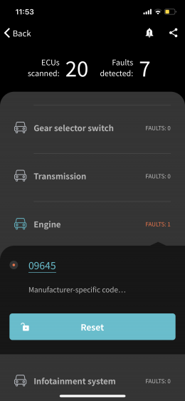

Plugged in Carista this morning around 15 faults come up. so reset them all as they were all related to mmi and doors etc the light has gone out will go for a drive soon and see if it comes back on.
on the app it didn’t connect to the engine so I’m guessing as the lights gone out after resetting the codes that were there it wasn’t engine related ? Also gearbox showed no faults so im hoping it doesnt come back
Let us know after the drive.
Well been out for a drive done 30 miles heavy acceleration etc light hasn’t come back on
the car did regen so I’m thinking it’s maybe wanted to do one as I turned it off to go into Asda and took a fit hopefully that’s the end.
Well lights come back on wirh a engine code.
code is 09645 but doesn’t stats anything else.
anyone got any ideas ?

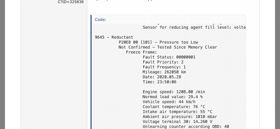

Just found this. 9645 maybe the same as he’s only missing the 0? Would this refer to adblue. i have the warning on 350 miles left could this be possible ?

Looks plausible that it has something to do with the adblue system, but whether it's that P code is another matter for someone more experienced. Try topping the system up, however, an EML seems excessive for a low ad blue level...
