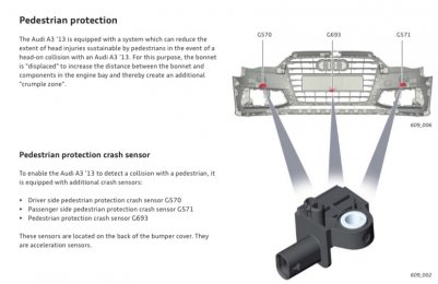

Sorry for the late reply, I’ve only just seen this. I’ve been away and am actually yet to sort this on my car. I did find this however, which may help with your part number problem. Maybe you managed to sort the sensor issue before this reply?
