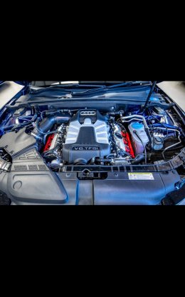

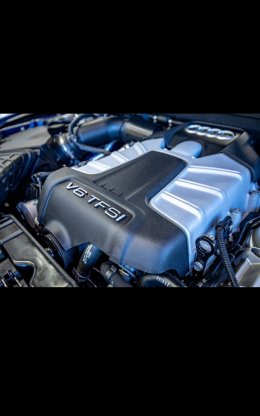

I've seen a 2014, reg June 2014, with low milage. However car is quite far away so I'll be asking a lot of questions before making a long journey. As it's a June 2014 car I'm thinking it'll be CREC engine, I've attached a picture, can you tell from this?
It is CGWC. CREC in a 14 plate would be hard to find if not impossible. 64 plate would be a CREC. Below is a picture of its cover:
74063E58 0893 4DF0 8C77 4317C27BEA4C
With the exception of a few, I have always bought all my cars from up north; always clean and low mileage and relatively better priced. One of A4 and the S4 from Aberdeen and Mrs’ A4 and A3 from Dundee. Even when I was looking at getting rid of my S4 and planning on buying another one, I was searching cars mainly up North.
