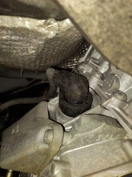

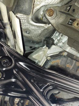

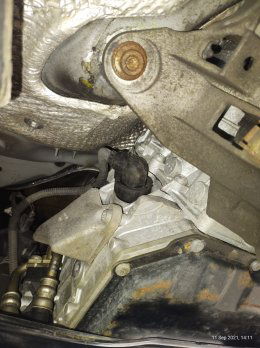

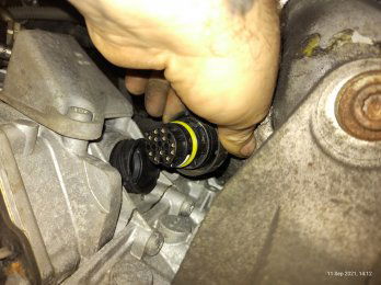

just for your curiosities, i was under mine today and checked mine to be ok
Nice and clean there! I had my diagnostics and they didn't put it down as 'definite' answer but likely to be mechatronics unit and they quoted £1,7k for it. Think I'll pass on that. Considering to use ecutesting.com and send my unit for repairs. Only having issues with logistics about how to get it done, since don't have a ramp and don't know if it will be difficult to take it out/put it back in myself.
