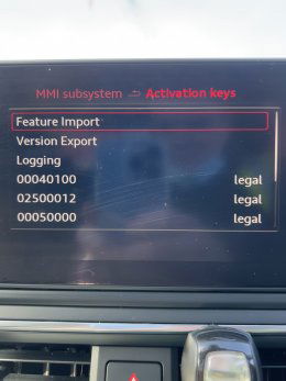

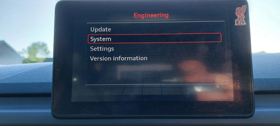

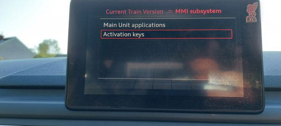

When you are next with the vehicle do the following and post a photo here:
- select and hold NAV and then within 1 sec also press and hold media, and after approx 10 secs the update menu will display
- browse to activations, which will display a list of numbers
- take photos and post
From these numbers I can let you know 1) what’s activated and 2) what maps (years) you can use.

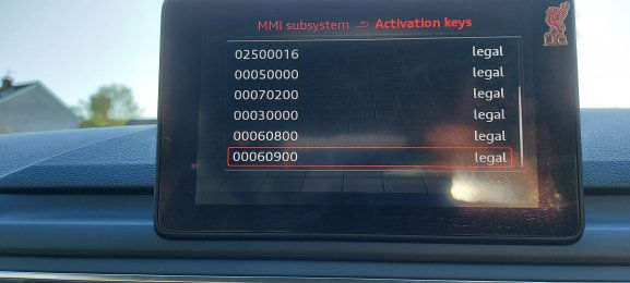

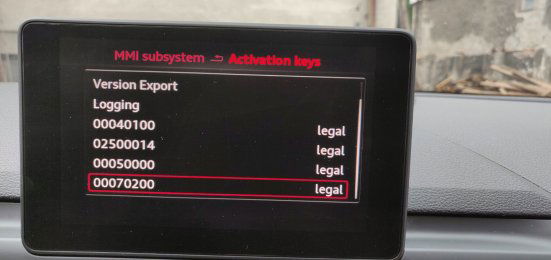

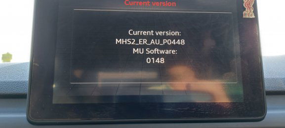

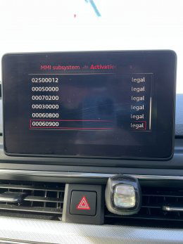

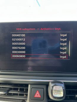

Thanks DJAlox,
I've done what you said and found activation keys? Hopefully those are the numbers you require? I'll attach the photos in running order and the current software it's running.
You will notice 2 sets of numbers because there was one I had to scroll down to ie: ending in 60900
T

You are fully activated for Audi smartphone interface and Audi Navigation + navigation data. Your current data licence allows you to use cards up to the version / release of 2016/2017. This is a crossover update.
what does this mean? In short go to eBay, search for an A4/A5/Q5 B9 Navigation data card from 2016 or 2016/2017, pop it in your media unit and all should work.

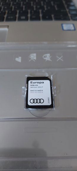

Thanks for letting me know that my system is activated, the thing is I have been given this card (photo attached) this is the one that only initialises to 25% as per my original post, does this mean that I've been given the wrong card? Or does it confirm as per my original post that I have to get rid of the apple car play that the previous owner had installed when she bought the car from audi?
Apologies for all these questions its so that I can go armed with knowledge so I'm not making an idiot of myself.

What you have been given is 2017 Navigation data but your licence / activation is only until 2016/2017, ie the card before this one.
To further explain audi’s stupid system, they release two navigation updates a year. One is a full release and the other is a crossover / interim release, so the scheme is basically as follows:
- 2016
- 2016 / 2017
- 2017
- 2017 / 2018
etc etc
Licence / Activation data for your Media System would look like this:
02300014 = 2016
02300016 = 2016/2017
02300018 = 2017
0230001a = 017/2018
You have been supplied the wrong card in short and you have two options:

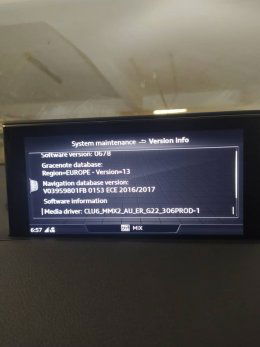

Hello DJAlix,
I have imported an 2016 AUDI Q7 TDI from UK to Malaysia.
Is it possible for you to update firmware/maps from UK to Malaysia?
Please see picture for software version.
Thanks in advance

Navigation is activated and up to 2016 data can be used.
