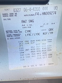

Hello. I have looked everywhere and i cant seem to find the rotor sizes. Called Audi and different aftermarket rotor manufacturers with not too much help. My car is a US based model 2017 Audi A4 2.0L Premium FWD. I have attached a picture of the PR Codes sticker in the trunk if this helps but i still cant seem to find too much info on the rotor diameter in mm . Does anyone know these measurements or where to look?

You're front brakes ar 1LF - 338 mm.

part no is 8W0-615-601-E (see link below)
quick search on this suggest 330mm
