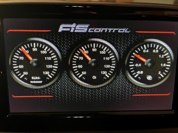

Been meaning to post about this for a while but thought it would be good to test this FIS control unit for a bit too. That's turned out to be a few months but I've not had any issues with it in my S1 and have to say it's absolutely fantastic. It lets you display any 3 parameters the car's capable of outputting from the can gateway in fully customisable gauge form:

Here's a picture (when the gauges were more crudely initially set up) at night so you can see the background which is pretty cool:
IMG 20210501 221607
You can also display 8 parameters in table form on multiple pages which you can scroll through using the steering wheel star button:
IMG 20210705 163441

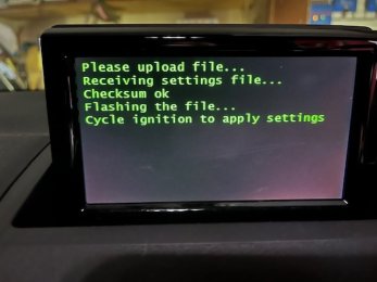

Finally got mine done too. Very easy to install, a little more tricky to get the gauges to display on the crappy low res display of the S1.
But here is my first attempt using the template available from the FIS configurator page:
Reactions: VeeFource
