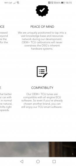

Their website says it's compatible with any ECU software but I'm leaning towards TVS.
Fair dos, all I can think is their website is out of date, maybe it doesn’t apply to the rs3 or the dealer gave me duff info lol.
