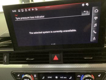

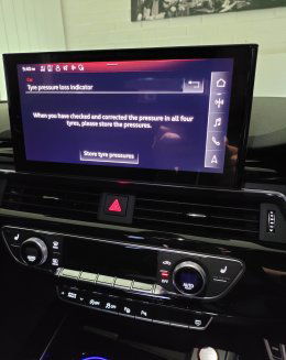

Hi
I've got a 21plate Vorsprung and doesn't have the proper TPMS, it only has the option to store the tyre pressure
Reactions: TallPaul_UK
