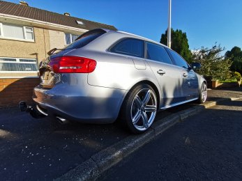

Just fitted two of my new wheels and am quite shocked at how far they're sticking out. I thought my wheels were standard ET43 but turns out my old ones are ET47 so these ET33 9.0's stick out quite far! Doh... Looks good at the back, perfectly in line with the arch but the front sticks out ever so slightly..
Have just been for a short spin around the block and not had any rubbing so hoping I can get away with it, as long as I'm not pulled over by a weary traffic cop.. will put the other two on when it cools down a bit and go for a longer drive..
If I had S4 arches they'd probably be fine but not sure if that's something I should think about or not.. probably need S4 bumper too so that's all a bit too much. If I can't live with these I'll sell them and get the 8.5's which I probably should have done in the first place :stupid:

Look spot on to me

Just got back from a quick 10 minute test drive, love the way it looks, super aggressive :)
Went over loads of speed bumps, fast roads, slow tight corners, full width sleeping policemen etc. no issues at all so far.. yay! The only thing left to test is with a full tank of fuel and some passengers, but 99% of the time it's just me. Very pleased.
Noticed my left rear shock is damp so must be leaking oil, just what i need but at least i know about it..

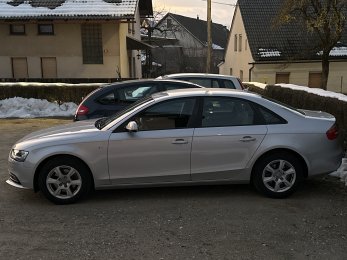

Yes I saw that now thank you for the reply.. Here is my car with this “regular” suspension and 16inch wheels. So my question is now if you have some experience how will he look with 18’s will he be even higher up or? The tiers will be 245/40

If you put 18 inch wheels and tyres on, you will want to lower it to make it look right.
