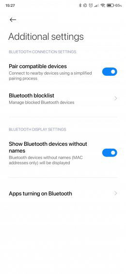

Bluetooth is backward compatible, modern phones will connect without issues. On some phones (especially Xiaomi), you might have to enable "show Bluetooth devices without names".

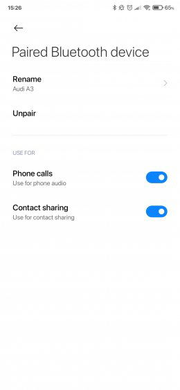

Be sure to navigate to the phone's address book, because the RNS-E has two address books, one that's from the unit itself and the other one is from your phone. This is how I thought that the original interface module didn't work with my phone. Make sure to enable "Phone calls" and "Contact sharing" on your phone in the Bluetooth settings (see attachment).
