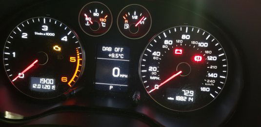

Might need some coding to be changed, or have you got the dash with pictures? rather than like this

Hopefully just some vcds coding that needs changing, IIRC @NHN YOu change the dash to rest of the world to get the big speedo

I think the various menus are dependent on the rom/firmware in the clocks. They may just need "awakening" with new coding

So,if i got it correct,if i change the dash to the rest of the world and other changes that i might want, i'll awake the menu feature.
It should do they are just dormant till activated, mine was

i have one.no options.only range,gas consumption and other stuff,but no menu or speedometer.
One friend of mine said that those options were introduced in 2007 and the dash number endings matter:
ending with : 930-no menu no speedometer
930g- small menu
931-speedometer,menu and codable needle sweep
so maybe i cant do anything about it.
Either you can code the dis to show more options or you may require a combo of coding, steering module upgrade & dis upgrade, ideally get vcds on it to check what options you have.
