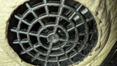

Hi Dave, I saw another thread on here about position of the sound generator so took a look and I have one in the same place in the door on the passenger side of the scuttle panel there's a fluid reservoir due to packaging but just about managed to get the part number. Should be easy to see if you have the box or wiring loom.
Hi Rich - really useful, thanks, and surprise surprise I have that part in exactly the same place. So maybe I'm only missing the actuator (4HO 907 601 E, £140 and available) that's supposedly somewhere near the rear silencer.

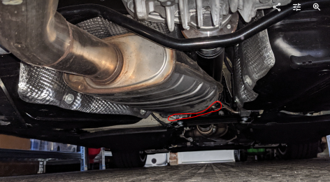

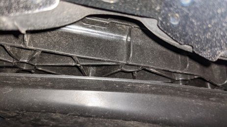

may be wrong but believe it sits above the flat plastic panel on the opposite side to the silencer

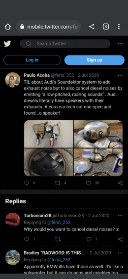

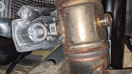

I can't help but feel this looks like an actual exhaust flap can't see any speaker being able to fit under the plastic cover on the drivers side I think that's just ad blue tank from what I can see.
I only say it looks like an exhaust flap based on some of the BMW images I've seen with what looks like a bearing on the far side.
That is in front of the rear silencer in the areas around the fuel tanks.
the noise on mine is definitely louder on the right hand side of the car but after having a good look underneath it’s not obvious where its actually coming from
where abouts on the car are the first two photo showing?

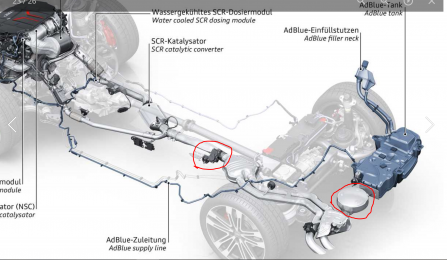

on doing some more reading last night its possible the valve is more related to emission control than sound, low and high pressure EGR but need to find this speaker. Only thing I've seen is on the S6 and SQ5 they have the speaker can on the rear of the exhaust, so need to take a look at the backbox to see if there are any electronics attached, they basically had a blocker on one of the exhaust valves right at the rear muffler, on those cars, but that doesn't fit with the part number Dave has which is aligned with a speaker.
On the SQ5 diagram I have circled the position of the vlave I found and the sound can which is an in exhaust speaker.

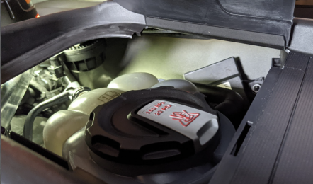

I did have a quick look after I got back but couldnt see anything obvious, wiring etc but the space above is really tight. The circular box that’s showing in the SQ5 picture is definitely not there however the back box looks to be much larger than the one on the SQ5. Wonder if the two have been combined?

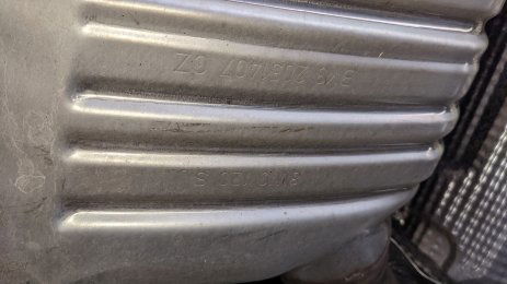

I can't really tell from this post if they are suggesting they took the left hand back box to pieces and that speaker was inside, if so there should still be some sort of wire attaching which I can't see, but that back box is a similar shape.
Anyone make sense of the part code on the back box?

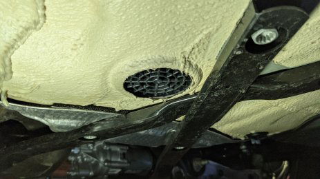

I've found the speaker, I might have some carbon monoxide poisoning having shoved my head under the rear of the car with the engine running..... But it's in the base of the rear wheel well which makes it very hard to spot!
Hoping you've got one of those Dave then it should be really simple for them to sort!
Reactions: Frizzley
Nice result - note to self not to ask local dealer for any info about the car . Ironically it must have been right above my head when I was looking at the exhaust earlier - just stuck my head under the back of the car and saw it instantly. Cant see from the inside though as the hybrid battery sits right above it.
Exactly the same had to have my head under it to find it, could feel the air moving off it on pronounced, as you say directly under 48v battery so hope Dave has one in place as that would be a pita to retro fit although I expect that will be his dealers job!
Just looked underneath and I have the speaker just like everybody else. Funnily enough it looks like a speaker! Quite how a main dealer and Audi Assist missed this I do not know. So I now think that it's a settings issue, especially as I found this on the AudiWorld forum. So it's a possibility that mine is set to 0% and that it can be changed to 100%? I presume Audi Assist have an OBDeleven or equivalent in their van? (In other news, I've escalated the dealer non-response to UK CEO of Inchcape and got an acknowledgment from his PA).

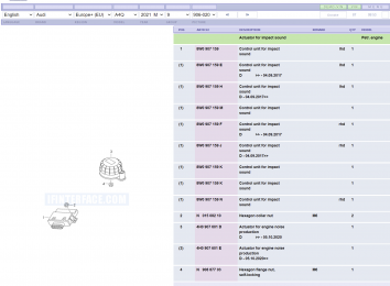

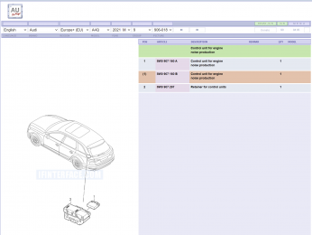

Ive had a few more looks today following Dave's question about the speaker and found the following diagram and control units, looks like the S4 at least has two active sound systems the Soundaktor and a sound generator.
The first is the one we were expecting to see and is common across all the VAG cars and is for internal sound (the actuator is actually next to the control on the firewall at the base of the engine).
Then I also found a part code for Engine Sound generator which is housed in the left rear compartment this I suspect is what drives the speakers in the exhaust on the SQ5 and S6 (the S6 has the same controller), for packaging reasons they are I assumed placed in the rear spare wheel well on the S4 and S5 and vent out through that hole with grill (I found images of third party installs using wheel wheels to install them so its not un-common, I would need to remove the 48V battery or B&O sound system sub to find out if it is there and I'm not ready for that just yet...

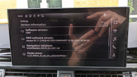

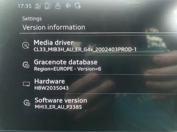

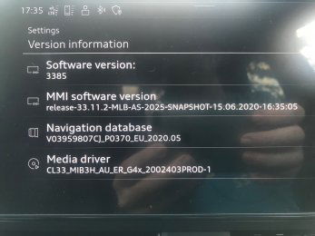

Might be getting somewhere, having escalated to the CEO of the dealer group. They are suggesting that a software update will fix the issue, which I am hopeful of. In the meantime, I've attached images of the current settings.
Sounds like good progress, at least there suggesting they will take some action, my mib3 seems to be on similar software versions but could be all sort of updates they could push be interesting to see what they do, I think they have a process of plugging the car in and getting coding updates and version revisions from a central server, doesn't look like your maps have updated to recent versions.

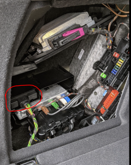

Happy to report that my local dealer fixed the issue this morning - under the subwoofer in the boot there was a connector to the active exhaust that wasn't connected - simple as that. Now it finally sounds like it should have, 78 days after delivery. Thanks to Rich, Frizzley and others on here who shared info and confirmed by belief that I wasn't being told the truth by the supplying dealer.
Very disappointing that the supplying didn't notice the issue, then denied it was part of the spec, then washed their hands of it and only called back (with no apology) when I escalated to their UK CEO. Audi UK Customer Service (probably outsourced to Capita and using Salesforce case management system) very efficient but ultimately achieved very little other than keep me updated to ensure they hit their SLAs.
Now time to go out for a drive!
Reactions: Keef
Awesome news Dave! Really pleased for you and such a simple fix and good to know it's under the subwoofer too as expected. It does sound good in dynamic when you launch it at a junction, a few people have also got excited on start up of the doors are open from the burble it's a good speaker!
