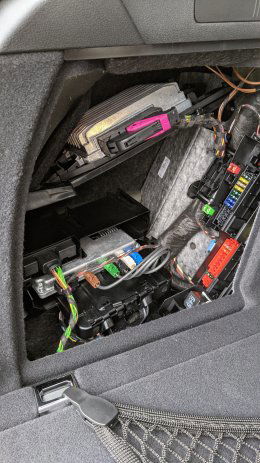

I have a MY2020 S4 and the control unit in the the left hand boot compartment (so I've been told). Worth checking.
Hi Dave, picked up today and there's a definite change in sound with the Drive Select, clearly audible at idle going from Auto to Pronounced. Only done 30 miles but lovely car and managed 35 MPG on the trip back, driving very gently at the moment as im a run it in sort of person
Not sure if this will help but my left hand boot compartment has this lot in it

Thanks for the pictures, my left hand boot compartment doesn't have the have the top metal box with pink clip or the silver box at the bottom with the 4 wires or as many fuses - I guess this all relates to Vorsprung spec. I do however have the fuse for the Sound Generator in the passenger footwell fusebox.

The 4 connectors look like fakra plugs so will be aerial related either phone box or maybe keyless entry.
Based on that website picture it's a little black box looks like the type that is above the silver box with the 4 aerials but it could be anywhere, anyone local to you that could run you a scan, then you'll know of the control modules in place.

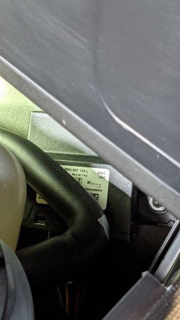

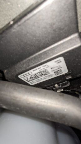

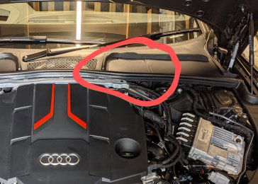

Hi Dave, I saw another thread on here about position of the sound generator so took a look and I have one in the same place in the door on the passenger side of the scuttle panel there's a fluid reservoir due to packaging but just about managed to get the part number. Should be easy to see if you have the box or wiring loom.
