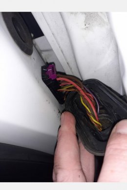

I recently bought an Audi s3 2010 previous owner mentioned that sometimes the drivers window won’t go down but if he slams the door it sorts it. I had the car sitting for a week and I noticed that the rear drivers side window also doesn’t work on its switch at the same time. None of the drivers door switches work when this happens as well. The problem now is now none of the drivers side works. Any body had this problem before ?
Check the wires from the door to chassis, behind the rubber boot for breaks
As Lee states check wiring, if all ok then switchpack is another to check.
Same thing happened to mine. See photo as to where the break in wires could be inside rubber boot at door hinge
