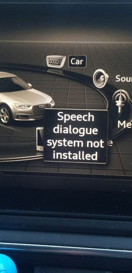

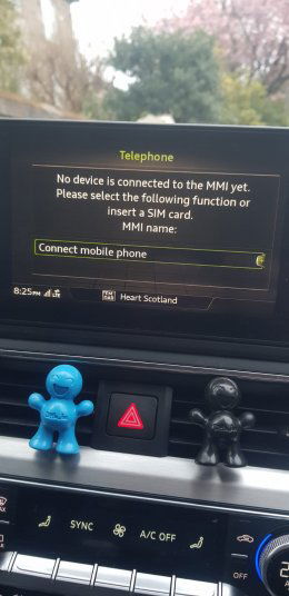

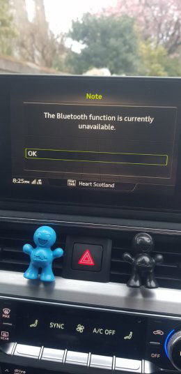

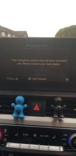

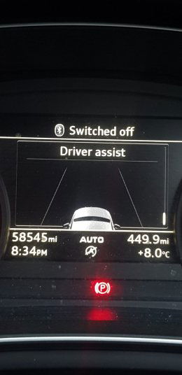

Hi,
i am having major issues with the sat nav, voice commands, bluetooth, android auto and other parts of my MMI.
i have my sat nav installed, use my blue tooth for phone music and also use android auto every time i get in my car. but all of a sudden my sat nav system is saying its not activated, blue tooth is switched off, voice dialogue is not installed and android auto is not working at all (it does work and not my phone as i use it in my own van for work)
i have attached some pictures that may explain better
has anyone ever experienced this. if so what's the remedy for fixing it.
i am also currently waiting for VCDS to be delivered to see if it shows anything.

What age is the car? Assume you have already checked the Bluetooth settings in the mmi menu.?
For the phone you could try deleting it from the mmi memory and the car details from the Bluetooth devices on your phone. Then restart the mmi and go Through the procedure to connect a new phone.

It's a 2016. So far I have put it back to factory setting, delete off my phone and reinstalled AA and still nothing.
What's concerning me is that its saying my bt is turned off and my nav is not active

Update....
I have scanned the car and nothing. I'm still stumped.
I did notice while trolling through VCDS I got into my nav part and it says the controllers are not installed.
Could they have some how removed?
Mr_Sport88
Well....car has been in at audi and the 5F (I'm sure that what they called it) component was corrupted and had to be replaced and installed again.
Took them 3 days to work it out as well Haha.
Thanks for your help guys

My car was still under warranty hence why I went back to Audi.
I scanned mine with my VCDS and it gave me no fault codes. The only reason i found an issue i couldn't fix my self was by playing about on it and noticed that certain drivers where not installed when they should of been - I needed another system to reinstall them which I don't have hence why I went back to audi.

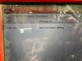

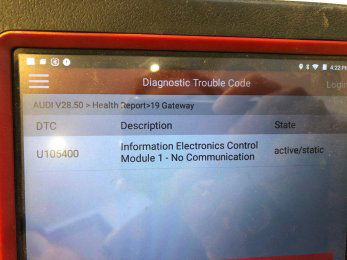

This is the codes I'm getting, has anyone seen these before ?
