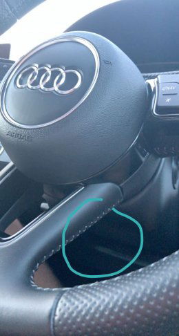

Feels like it’s coming from area between steering wheel and pedals. It’s a metal rattle on rough roads that seems to be the only factor. Nothing with turning / braking etc. Wish I could put a video on here!
