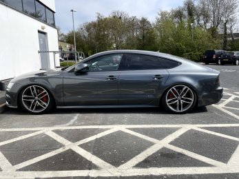

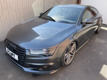

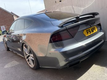

So got my A7 in December and the paint was in pretty good condition with a few swirls, but I wanted it looking perfect - have performed a 2 stage machine polish using Koch chemie combo of H9 and M2 obviously fully decontaminated first (car was covered in paint flicks from my neighbour painting his fence!)
finished off using KKD Sistal - light alternative to ceramics offering around 12 months protection, but a doddle to use, apply flash remove no need for particular temperatures and no lengthy cure - plus it’s great value for money, I used 15ml and applied 2 layers

Andy, have you lowered the air suspension using VCDS please?.
I’m pretty sure there’s a procedure for it with VCDS.
Reactions: RS3 S.
there is... but I'm not sure how much adjustment you can get, i think it works from base and you can do -20mm or something, and that becomes base, so you have to kinda log your starting point
the cete module is awesome, i can set a height for every driving mode and put in a safety speed at which it reverts to stock
