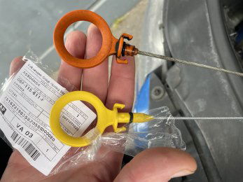

Just thought I’d share this with people in case it is not well known and stumbled across this by accident when trying to order a dipstick gasket at TPS yesterday.
They sold me a yellow whole unit rather than just the o ring at top, as an inlet smoke test the other day showed smoke & hissing from my original.
To start with, I was annoyed they sold me the whole unit but on looking, it is identical apart from re designed top seal section as you will see in picture.
I fitted, and has stopped rough idle, chugging like a diesel when pulling away slowly, made the car (driven slowly) run so much smoother and so on.
I am about to try and add pictures of the 2 side by side to show failings and differences along with vwag sticker
Bear with, as I am new to forms full stop so may struggle to add my first pics

Yeah you need to keep the pcv sealed, that worn dipstick wouldn't be keeping it sealed
It won’t let me post other pictures as it says file too large but the above pic shows everything needed.
Sorry people, you will have to zoom in.
I’m sure I will work it out but posting is all new to me. Sorry everyone
It absolutely did not mate that’s for sure.
just thought I’d let people know..... if they don’t already that is.
I bet the majority of un changed ones won’t be sealing pcv thus on idle giving slight un metered intake air leak

So to clarify, this part is exactly £10.45 + from TPS and the old one , I would imagine never properly seal as it allows the o ring to slide all the way up to the top and requires constant hard downward pressure on it to make it seal
the new one has a captive groove to lock the o ring in place lower down and actually seal properly.
Hope it helps anyone that doesn’t already know this and pic shows exact part number.
my car is 2008 BHZ s3 8P but I’m sure all positive crank case ventilation engines will have same issues which is why it’s in general not 8P section !

I would say yours snapped the lower part of, hence the o-ring not seperate & why your o-ring is at the top,, hence why its not sealed, just checked mine & its designed as per your new one & mines year's old, so its the same version, but a different colour.
Fair play mate.
obviously my issue is fixed now, changing to new yellow one.... but if you can be bothered that is, I am interested more than ever now after re - looking at my photo. It does look snapped.
I would like to try and match yours up with my part number to mine if I can’t physically see 100% if it has snapped off just out of interest really as I always like to see exactly how and why things fail and I had just put it down to a vag fault and revised part was a cure to the issue but although it snapping off would still not be great, and still a fault in manufacturing, it would be better than them putting the seal right at top with no chance of ever sealing from factory as the orange one is in pic
Is your one orange?
and is part number where the part has snapped off on my one?
I’m going to go and have a look at my one now to see if I can tell what has happened.

Yes I had a look the other night and it has definitely snapped off and the previous owner, rather than fixing, obviously thought it to be ok to just stretch o ring to the top in the hope it sealed (no chance there)
