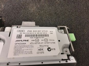

Also what brand is that radio? Just a OEM Audi? Not made by Alpine?

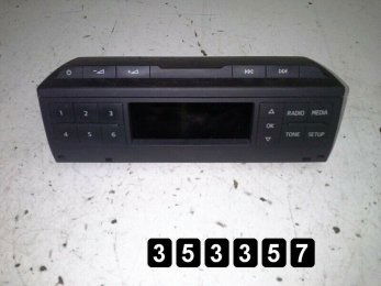

I got what you mean now. Those screens like the one in the picture are controlled through buttons next to the gear?

I think the one in the picture is mine.

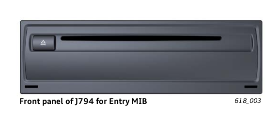

ok so what you have here is what's called an MIB Entry System which is made up of the glovebox control until and then the dash mounted screen and controls. You would need to upgrade all the parts involved in order to have a working MIB Standard, HS or High system, example:
  1. MIB2 HS Glovebox control unit
  2. MIB2 7" Screen and connecting cables
  3. MIB2 centre console controls and connecting cables
  4. USB Ports and Cables
  5. Replacement Armrest Storage Compartment
Your current system does not have a video output so a screen cannot be connected to it. You also have an issue in that the centre console control cabling will not be in place and will be hard to find given that its normally part of a larger wiring loom.
What might be possible and more cost effective might be a 3rd party solution from eBay our AliExpress, something that connects to your existing media unit and then replaces your display however most of the systems I have seen are not going to work with your current system.
