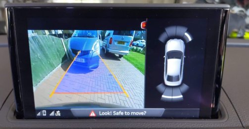

It gives you dynamic guidelines, I believe this is called the 'high' install in the adaptions
IMG 20210330 WA0001
it comes fully programmed and ready to be switched on

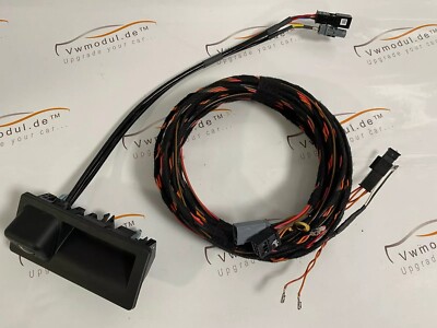

Potterswheel: Very interested in your reverse camera retrofit, and I’d appreciate some extra info:
How difficult was it to install, and how good were the instructions that came with the kit.? German? Did you need anything in addition to what was supplied? Did you need to do any coding? Was your purchase postBrexit, and did you get hit with any extra import charges?
Mike
First off, my car is a saloon, I believe it is a lot more difficult to fit the Camera to the sport back hatch and there are others who will tell you about that. on the saloon the most difficult thing was removing the trim and getting the cables to the back of the fuse board and MMI in the glovebox, I am retired and took my time and didn't find the job too difficult. I do have a tame coder who did all the necessary coding for me. There used to be a very good step by step guide in the FAQ 'how to' thread which I used but the link no longer works, It was for both the hatch and the saloon.

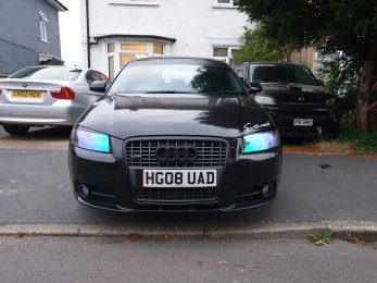

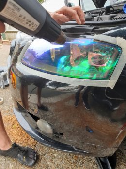

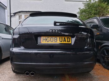

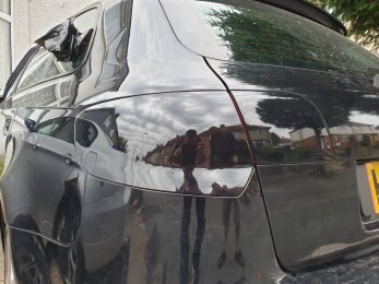

I wrapped my headlights, fogs and rear lights, also wrapped the chrome grill surround and added a sunstrip, also done my blacked out badges. Cheap and easy to do the wrapping if you know your way around a scalpel, skweegy and heat gun.

Reverse camera is easy, I used :-
generally trouble free and 'right'
